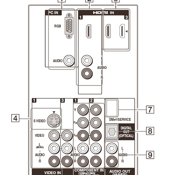

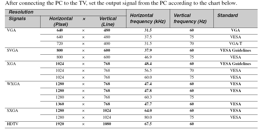

okey doke first off you have 2 choices,
RGB or HDMI/DVI
then you gotta make sure that one of the emBoldened options,
is set to your output, USE ONE YOUR CURRENT MONITOR CAN SUPPORT.

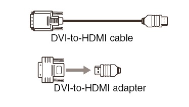

Then plug in to the bravia using the RGB cable, if thats the one you use, if you use a DVI cable you will need to get a HDMI to DVI cable, or HDMI cable with a DVI adapter.

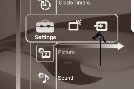

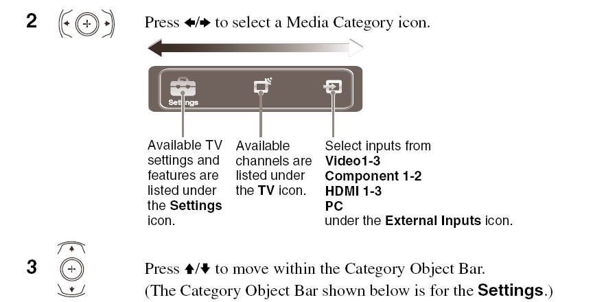

then go to
on the xmb for the telly.
and sellect pc input for RGB or HDMI 1,2 or 3 depending what HDMI socket you choose to use.
hope this helps

It was the settings xD Thanks for pointing that out.
Appearantly the PC input setting was disabled, I enabled it and now it works like a charm.
